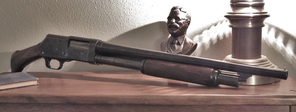

This showed up in the mail today. It's a Wards-Western Field Model 35, a late production knockoff of the Browning-designed Stevens Model 520; it's missing a little off the front and a lot off the back, and it's chambered in that weirdo intermediate 16-gauge that nobody seems to want anymore...but for under $200, why not. Besides, those old double-hump shotguns have a certain appeal.
Weirdly, this will be my third $200 +/- project this year. Something about a mistreated and neglected two-bill gun that gets me in a fixing state of mind.
In that case it'll likely be an eventual reblue to remove some of the pits and scratches the last refinish didn't quite cover, a general smoothing out of what remains of the stock, and maybe some feeble efforts at checkering. I expect to put more into this than it's worth. On the other hand...can't take the money with you, and I could be snorting it, I guess.
Ugly and cheap, maybe. Still got a certain swashbuckling air, though. Just the thing for repelling boarders on your zeppelin or knocking over convenience stores in south Oklahoma.

That looks like an interesting project. Even though some has been cut off the front it still looks long, if you don't mind what is the overall length of the weapon. Is it difficult to obtain 16 GA ammo?

Not as bad as I thought, though the options are somewhat less than you'd get with 12-gauge. The store price for sixteen is around a buck higher than twelve and about on par for twenty. Overall length is 28 ¾" with a barrel length of 18 ¼". I suspect the apparent length is a trick of the eye, being as the first move of everybody at the shop to see it was to reach for a tape measure.
Other than some touchup work it'll stay mostly as it is now as it makes a passable imitation of a similar model owned by Clyde Barrow.
